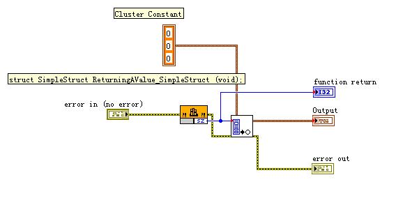

Hi, all.
I downloaded the LabVIEWWrapper.zip from this place:https://decibel.ni.com/content/docs/DOC-9079
And I run the following VI in "LabVIEWWrapper_PassingDataSampleDLL.lvlib"
I did not change anything in this VI, and when I run this VI, the labview just collapses and exits without any warning or error code.
Could anyone tell me what's wrong with this?
Thanks and Regards

Did you read the Excel sheet that was included in the document? According to that the
Returning A Value Simple Struct Added.vi
and
Returning A Value Pointer To Simple Struct Added.vi
where not generated whatever that means. At least this document seems to state that various of the test cases where either not yet tested or were working incorrectly at the time the document was created.

Actually there is no correction for this VI and for the same with a complex struct. We are talking about the 2 functions which return a struct, not the ones using a struct as a byref param.
Message 5 of 10
(3,361 Views)
There are a few problems with that example. The simpleStruct example is already problematic.
How the SimpleStruct is exactly compiled by the compiler is very compiler specific. If an operand is larger than a register the compiler may choose to either return a reference anyhow or a hidden pointer parameter that the compiler will assign the return value to.
typedef struct
   int val1;
   int val2;
   int val3;
} Int3Struct;
Int3Struct MyStructReturn(void)
    Int3Struct str = { 1, 2, 3};
    return str;
 Since the 3 integers do not fit into a register (also not on 64-bit) this will
 be compiled into one of these two forms, depending on the compiler */
Int3Struct *MyStructReturn(void)
    return &str;
void MyStuctReturn(Int3Struct *str)
    *str = { 1, 2, 3};
This obviously will cause problems if the caller and callee are not compiled by the same compiler. And since LabVIEW is not only not the same compiler but a completely different environment, things get even more complicated. The first variant is in fact equal to the Return Pointer to SimpleStruct but if this is what Visual C does is up to discussion (and disassembly of the DLL).
The bigger problem in all these variants but the last variant is however that the struct is allocated on the stack and then returned. However as soon as the function returns, the stack is not valid anymore so what is in the memory at the time you try to read that in LabVIEW is random at best. The variant that returns explicitly a pointer to that struct is making it not better as now both the pointer and the struct are on said stack. You now have the chance that the pointer itself is destroyed. BUMM.
This has absolute nothing to do with LabVIEW but is basic C programming trouble that you have to deal with first and fully understand before you can even hope to understand how to interface to such code from LabVIEW. C was never meant as a cross platform, cross compiler and cross programming interface but it is all that is available when calling shared libraries. It's not a deficiency of LabVIEW but a fundamental problem about calling C code in general and shared libraries in special. No LabVIEW tutorial can and should even attempt to try to explain you such problems. If you want to deal with non scalar variables at all, you are bound to first learn all the C trouble they come with!
The ComplexStruct does not seem to allocate the struct on the stack, most likely as debugging has shown the returned struct and the contained pointers to be destroyed sometimes. Instead it malloc() the struct and the internal pointer, BUT it is never calling free() on them. Welcome in memory leak land.
And the use of malloc() in the DLL does prevent the use of free() in the caller to the DLL. Since the malloc() is really implemented in the version specific C runtime library that is linked to the DLL. the free() has to be called from the same version specific C runtime. Not the C runtime that LabVIEW was compiled with and not any other C runtime either. So you would have to know what Visual C compiler version was used for the compilation of the DLL and then locate the specific C runtime DLL and call the free() from that DLL That is if the programmer building the DLL didn't choose to include the C runtime into the DLL at the cost of increasing the DLL size. Then you have no way of locating the correct C runtime functions at all. The only useful solution for this to also export special deallocations functions from your DLL too that call internally the free() functions and instruct your caller to use these special deallocation routines for any value that is allocated in your DLL (and of course document also which parameters and value that concerns!!!). This is the only way to make sure to call the correct memory manager functions from the right C runtime library.
Basically the examples in that document go way to far as they touch areas that can't even be generally described, since they go into C compiler specific details. With such things, it is totally pointless to even try to document what should be done to call such code from an environment like LabVIEW. It also runs into problems with stack variables being returned which is a total nogo. The alternative of declaring the according variables as static so they are not allocated on the stack but rather as global variables avoids the problem of the struct variables going out of scope as soon as the function returns but gives a very bad example as such code is anything but multithreading safe and suffers from race conditions. The only proper solution is consequent dynamic allocation of such variables but that creates new problems about having to do proper memory management by the code and all its callers. That includes LabVIEW, which for most LabVIEW programmers is a very foreign concept and therefore goes most of the times wrong.
