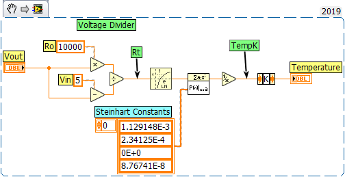

Hi Paul,
do you know of the polynomial evaluation?
I was too narrowly focused on doing a function-by-function conversion to G.  Using that simplifies the G code even more.
Btw. according to Wikipedia you calculate a3*ln(Rt)^3 and not ( a3*ln(Rt) )^3…
My mistake  --  which underscores the difficulty in reading text formulas.
Here is a fixed up version:
Message 12 of 13
(1,111 Views)
