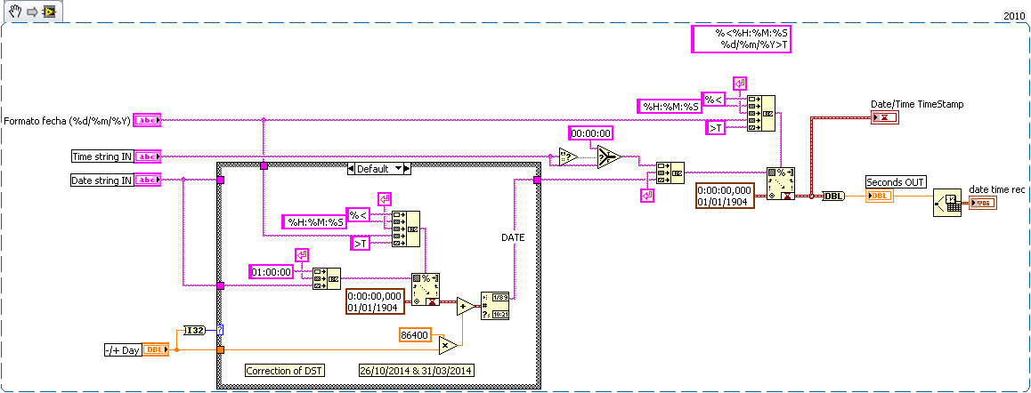

I've created a subVI that transform an string data/time to Time stamp format.
The subVI seems that it works fine, but when I use the data 26/10/2014 and I add 1 day, it crashes! The result is 26/10/2014 23:00:00 instead of 27/10/2014 00:00:00.

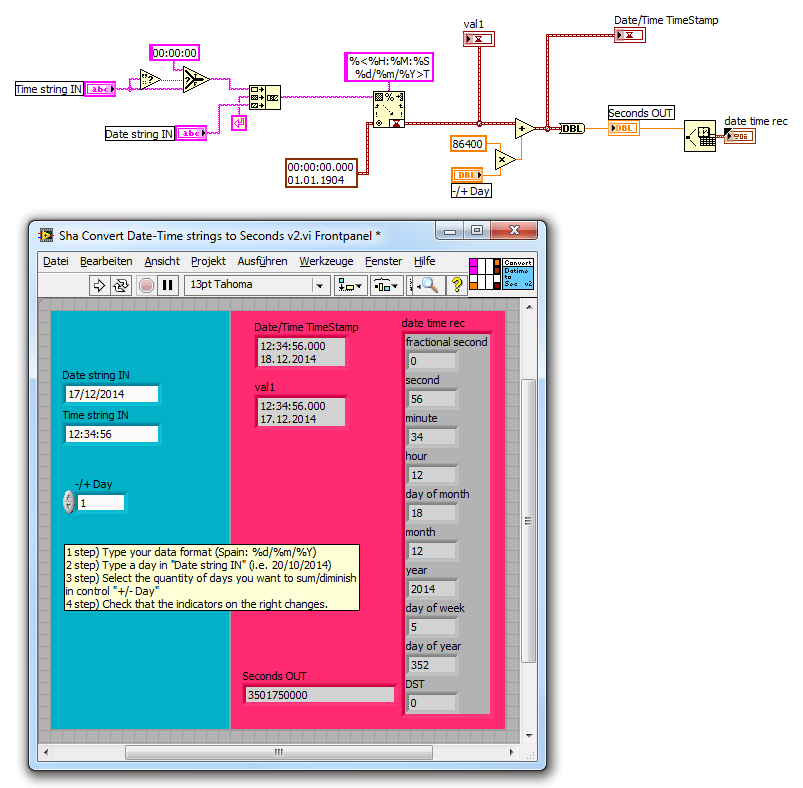

What is the timestamp before you add 86400s to it?
Here's the result on my computer:
Looks ok to me…

October 26th 2014 was the daylight saving time change in Spain.
Ben64
(3,878 Views)
Accepted by topic author vicens
Thank you both!
I think I've solved the problem.
