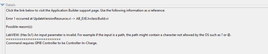

Error when building executable "error occurred when updating the resources in the application : 0"
hello,
how can i resolved this error please?

I get the same error message when building an application with LabVIEW 2024 Q3 (32-bit) 24.3.4f4.
