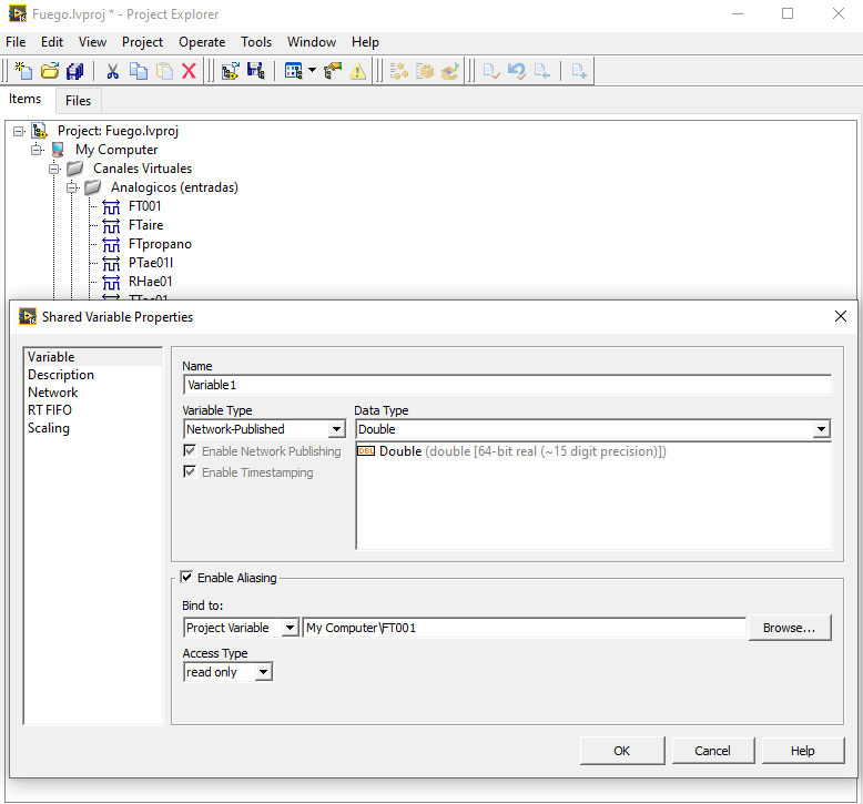

In my development team, i bind my ni-daqx channel "FT001" to my variable "Variable1" (enable aliasing).

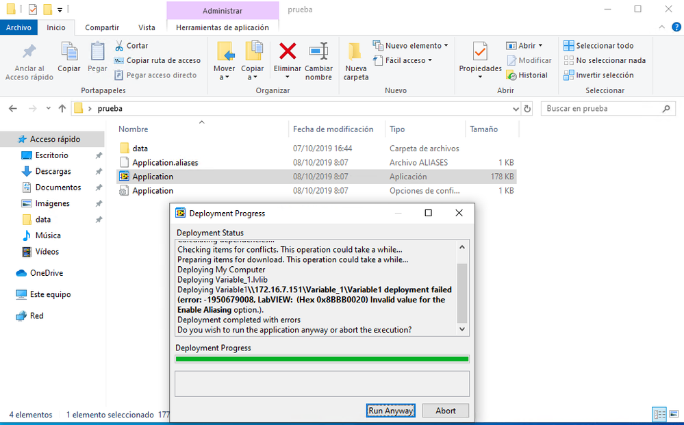

Later, after the build of the .exe aplication, i try to execute it on the target computer an i get an aliasing error with the variable.

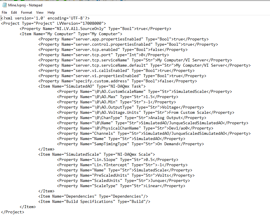

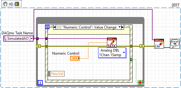

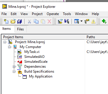

A string might work but, WHY not CREATE the Task, Channel, Scale, DAQmx things in the Project?
For about 3000 words....
A Very simple project
With a simple Main.vi
And if we open the PROJECT file in a text editor we see the DAQmx "Stuff"
Yup, All the DAQmx-yish things are right there in that *.lvproj file (you could even edit outside of the LabVIEW IDE-----Don't do that!)

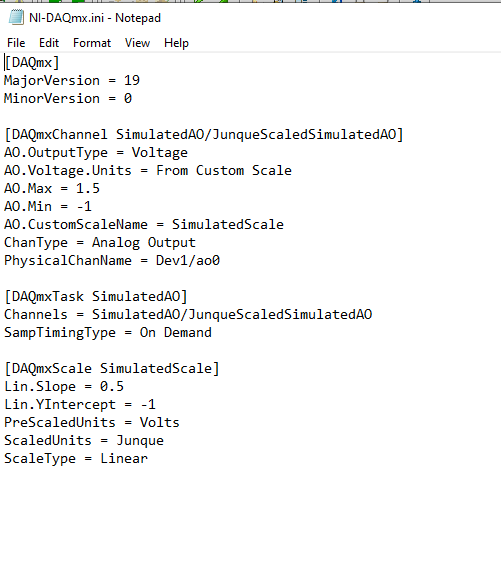

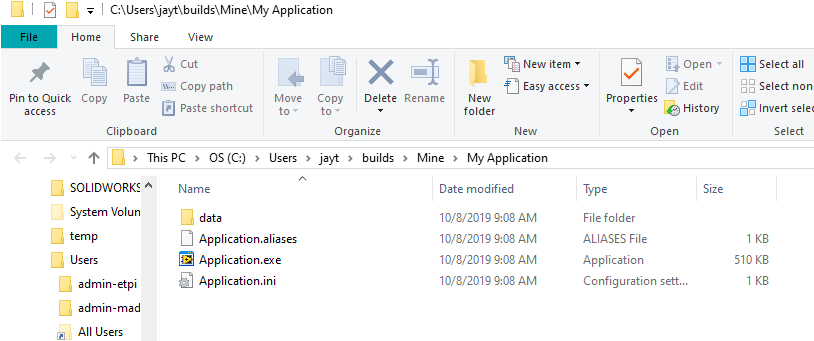

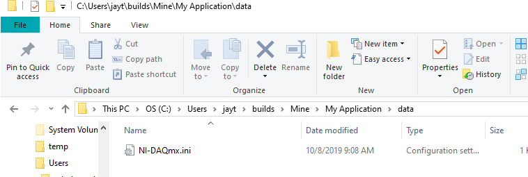

So, what happens for "Deployment!"? oh....  This configuration file is written for you in the build output!
