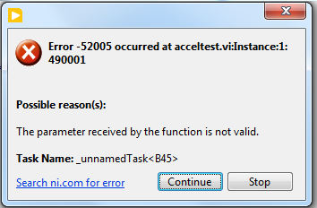

Unfortunately we are still getting the same error : -52005

Your sample rate is 1000Hz; you are set up to acquire 5 samples at a time, or in other words acquires samples every 5ms. This is normally too fast, set the number of sample to 100 or 200, so you update every 5 - 10 Hz. See if that works.
mcduff

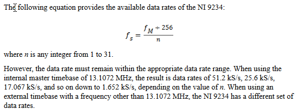

EDIT: Also just saw that you are using a 9134. Look in the manual, your sample rate is incorrect. 1.652 kSa/s is the minimum rate. See snippet below. Change the number of samples and your sample rate.
