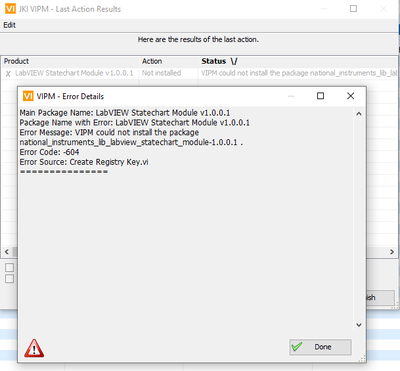

When I try to install the package in LabVIEW 2019, the installation is aborted with the following error-message:
Is there a workaround or fix for this issue?

The error is caused by the package itself. More precise: the error is caused by a post action where some Windows registry settings are set. It seems like this action is not allowed causing the installation to fail.
Most packages from NI have a support-topic where you can give this kind of feedback to the NI employee who created or maintains the package.  But currently the Statechart Module package hasn't and the reason why I post this in the more general LabVIEW board.

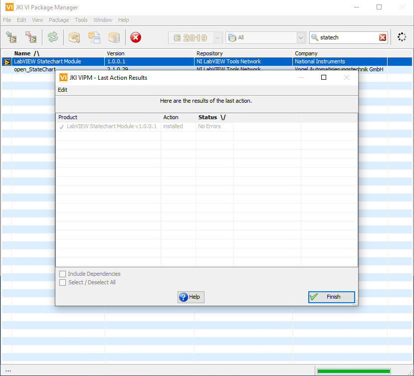

Found the solution myself ... Smiley Happy
The error was caused by JKI Package Manager having no or not enough privileges to manipulate the Windows Registry.

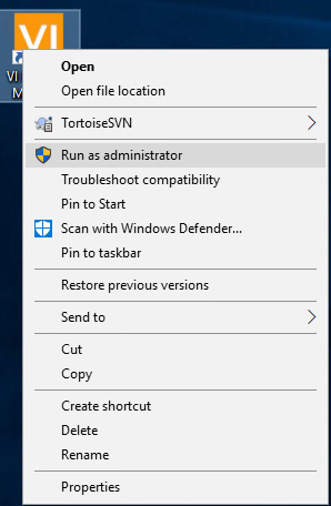

Installation finishes successful when the permissions are elevated by running JKI Package Manager as administrator.
This is done by right-clicking on the shortcut or start menu-item of the JKI Package Manager and selecting "Run as administrator" from the menu.
Statechart VI Package Installation sollution - RunAsAdmin.PNGStatechart VI Package Installation sollution - RunAsAdmin - SuccesScreen.PNG
