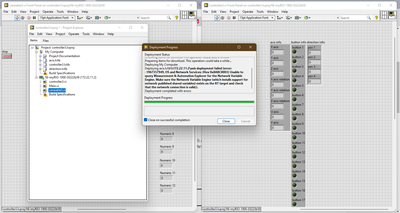

Hii, I am trying to run this code that connects a joystick with MyRio and LabView but I am facing a error that I couldn't understand what the cause is.
This is the error that is shown:
Deploying axis.lvlib\\172.22.11.2\axis deployment failed (error: -1967357949, OS and Network Services: (Hex 0x8ABC8003) Unable to query Measurement & Automation Explorer for the Network Variable Engine. Make sure the Network Variable Engine (which installs support for network-published shared variables) exists on the RT target and check that the network connection is valid.).
axis is the name of the library that I created.
Anyone who knows how to solve this issue please help me, thank you!
