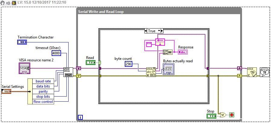

Read the manual of that Neutron detector. What is the termination character you need to use? 99% of the cases, the "Bytes at Port" approach is the wrong way to do communication from LabVIEW.
So try to use the specified termination character, and delete that "Bytes at Port" property node. Set a large enough (that any msg fits into it) byte count intput for the VISA Read. Also delete that 500 msec Wait from the While loop. Beside, you mentioned your detector sends data at every 2 seconds. So you need to specify a somewhat larger Timeout for the VISA Configure Serial Port, see the snippet below, I set 4000 msec value for it.

Thanks for the response and the information regarding the use of the "Bytes at Port" node. The manual for the neutron detector makes no mention of the termination character, but I did look found a Carriage return when studying the received bytes in the Termite terminal program. I changed accordingly, including the earlier suggestions, but the same type of messaging errors remain.
