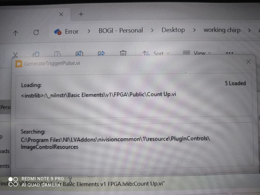

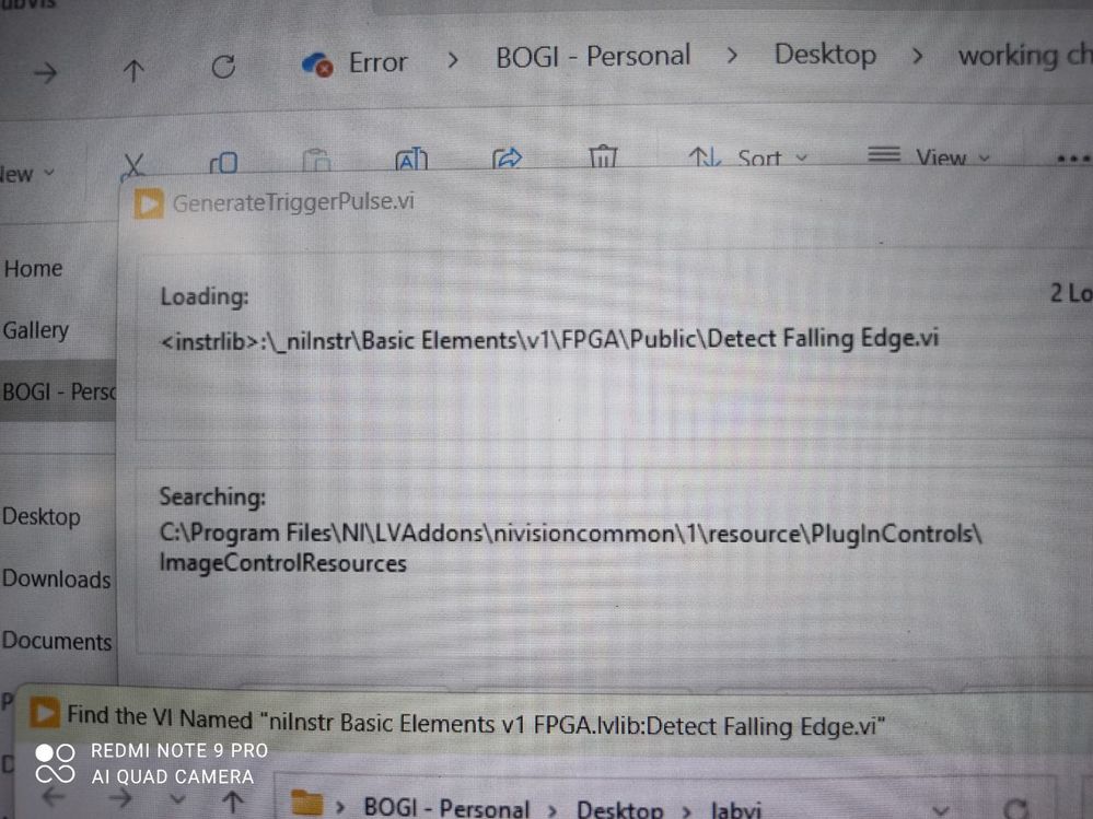

While i am trying to run a file named gatetrigger.vi its showing so.e sub.vi are missing and one of them is
Count Up.vi" was not found.
" Expected path: C:\Program Files\National Instruments\LabVIEW 2023\instr.lib\_nilnstr\Basic Elements\v1\FPGA\Public\Count Up.vi"
I only have till
"C:\Program Files\National Instruments\LabVIEW 2023\instr.lib\"
In my laptop how do i resolve this.photo_2024-03-16_23-08-50.jpgphoto_2024-03-16_23-08-44.jpgphoto_2024-03-16_23-08-37.jpgphoto_2024-03-16_23-08-57.jpg
