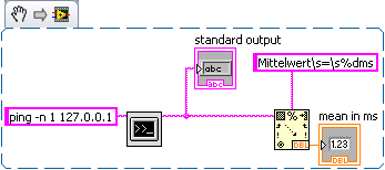

How about using ping?
Feed the output  into a scan from string to read the value you need. Sorry my OS is answering in german so you will have to adapt it 😉

Hi, Henrik Volkers.
Thanks for your help. It may be the subprogram I need, but I want to ask what is the icon that immediately comes after constant "ping -n 127.0.0.1".

Hi yukfai,
it's called "System Exec" Smiley Wink

Thanks, GerdW. I can find it now, but I also want to ask what is the format string in the "Scan from string" vi, which is "Mittelwert\s=\s%dms". Thanks a lot.
yukfai88
If I'm reading it right, that will extract the average ping time (using german ping output though, you'd want Average instead of Mittelwert if your ping language is english)

And it is a useful habit to RTFM ....for the ping command enter "ping -?"  in a cmd-window (I prefer "man ping" ... however that is in another world 😉
In my example the "-n 1" tell ping to only use one request so there is no meaningful average 😛
