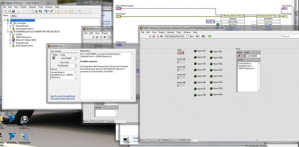

Hi, After trying the provided files and solution I got the following Error:
Error -2147138468 occurred at Invoke Node in WriteInitCmd.vi->DEMO Ethercat.vi
Possible reason(s):
CoE operation fails because the CoE service is timeout. Ensure that each device in the EtherCAT network is powered on and properly connected
I also did a wireshark capture, I think it got nothing weird, but I attach a link to it(it's to heavy to attach here I think)
https://www.dropbox.com/s/rfyovynf5iyogcq/Ethercat%20capture.pcapng?dl=0
