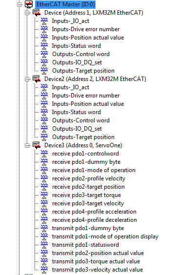

To answer you, here is the list of the variable we use for this project :
Do you think a 9068 would be able to exchange all this list a variable in a cycle time of 125µs ?
