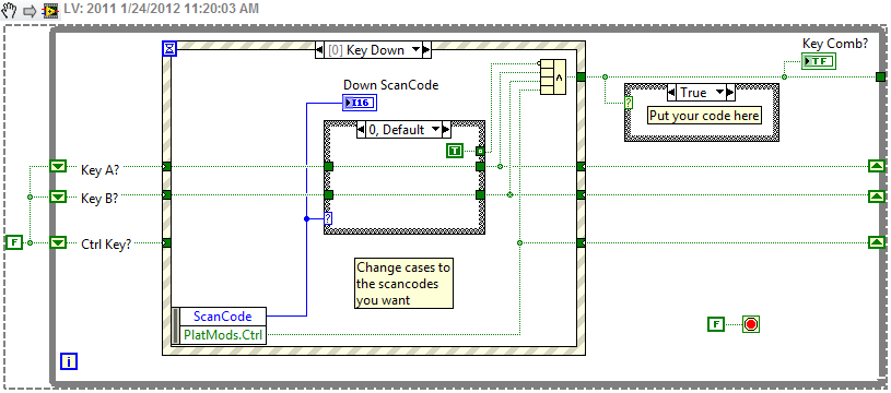

I am interested in placing a subVI in an event structure. The subVI will allow a user to change specific control setpoints for a seperate application I am running on a cRIO. I do not want to use a button, because these control setpoints should only be changed by specific people. I am interested in doing a CTRL+Button(a)+Button(b) that will register as a user event and execute the subVI. Is this possible.

I want a computer keyboard combo similar to ctrl +alt+del. Not a LV button that would be clicked on the FP. I want lv to register a keyboard combo similar to how windows would recognize the combo listed above.

I think there is an easier way to do this. If someone has a better way I am sure they will reply.
But basically it boils down to keeping track of which keys are down.

Thanks Steve! Your example got me going in the right direction.
I used CTRL+ALT+H as my combo. The attached code is how simple it can get. Not sure there is a better way than what I did Smiley Very Happy
