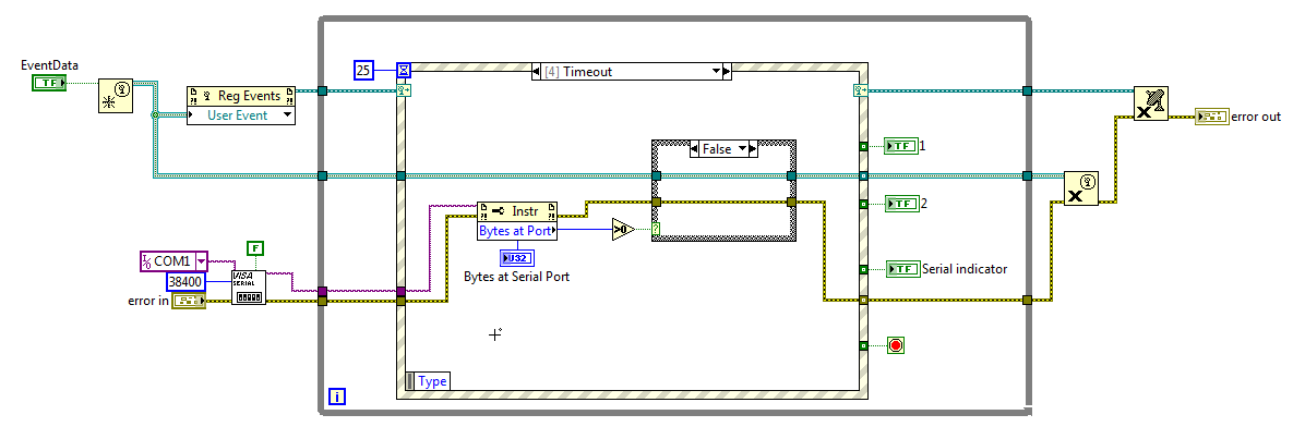

I do not think this will solve all your problems, but I would move the external loop (check port section) into the event structure.
The obvious place to do this would be in a timeout state.  This also gets rid of all of your stop local variables.
Also it is probably not healthy to constantly poll the serial port for the number of bytes available without a pause...

Something more like this

Well, I thought I'd add a final post for some closure to this one.
To summarize what I was trying to accomplish: I wanted to have some kind of an event structure where you could use both regular User Events (button pushes, numerical control changes, etc.) and an outside (non-keyboard/mouse/touchscreen) event, like a serial character coming into a COM port, to initiate an action. This was to eliminate a loop where the computer would be polling the COM port continually at a pretty fast rate. (I must have read a hundred times in the past month that you don't want to run a While loop for polling if you can help it.)
It turns out (after a couple of confusing days, I talked with the NI service engineers) that you can't do this. In order to detect a character at a COM port, you have to be polling the port periodically with a Read and look for a change in the bytes available or another parameter. You can do this through a timed loop separate from your Event loop or through a Timeout event case inside the loop, like Don_Phillips suggested.
However, I believe I'll go the separate loop route, since my head's actually more comfortable with it than the Timeout route.
