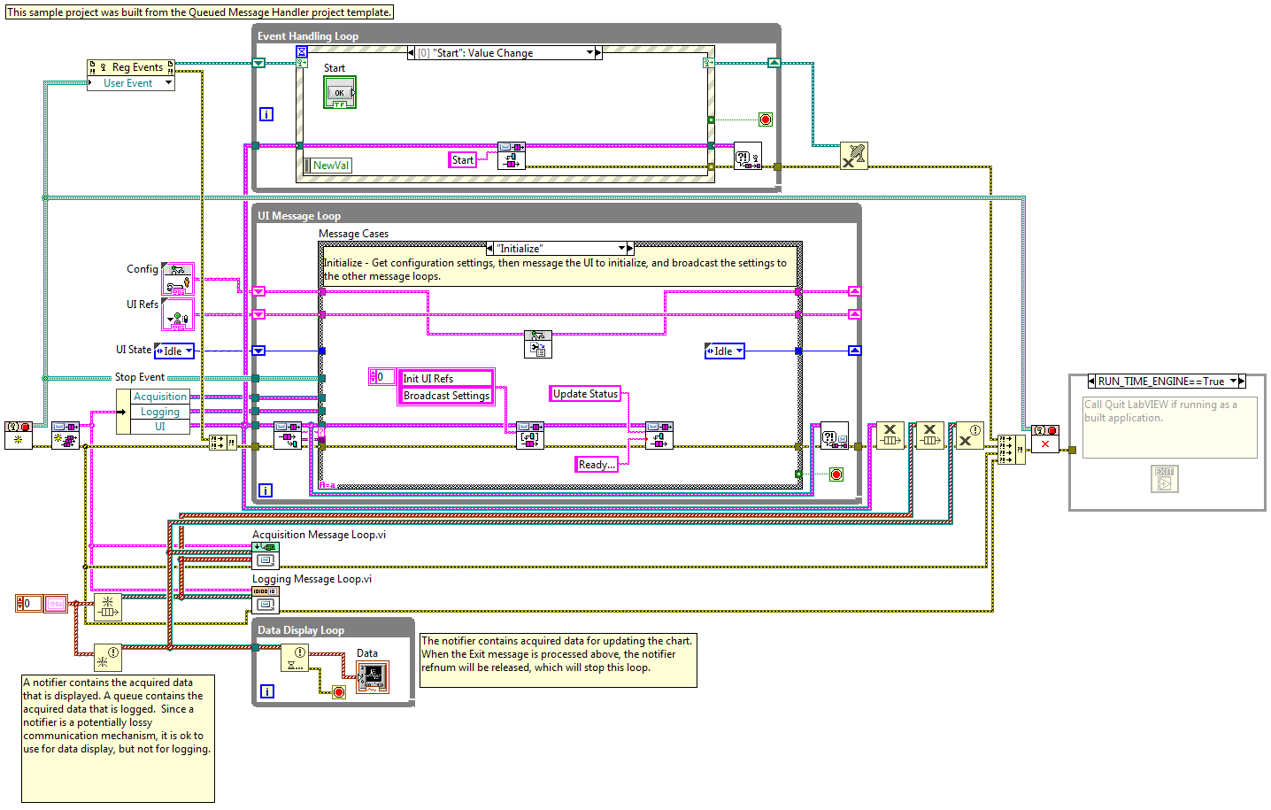

This is one of those times when the Project Templates really shine!
Personally I would start from "Continuous Mesasurement and Logging.lvproj" and add a "Control" Loop to handle the Stepper Motor commands from the "User" Event loop
The documentation is excellent and the developer Walk-through makes it easy to understand what is going on and how to expand it.
