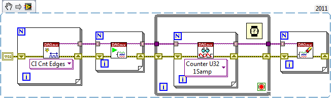

This is true, you can't group the counters into a single task.
Extending your single counter proof of concept VI to multiple channels shouldn't have to create a wiring mess though--you could use some for loops for example (I didn't wire the inputs, but you get the idea):
