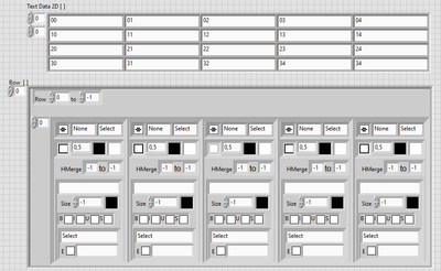

My question is: Is it possible to create two tables and arrange them in one line without line feed as shown in the next picture: 

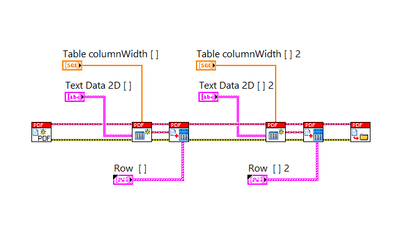

My suggestion was:
but this doesn't work. The second table appears under the first table. Is there a possibility to arrange them in one line, so that the second table will appear next to the first table? Maybe there is a flag, that indicates a line feed and it's possible to deactivate it, but I can't find something.

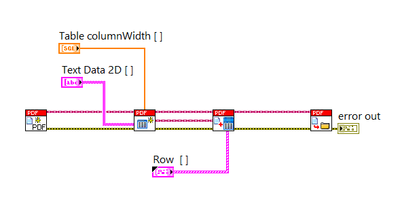

you can tray this
with this configuration, pay attention the cell border
that works for me
