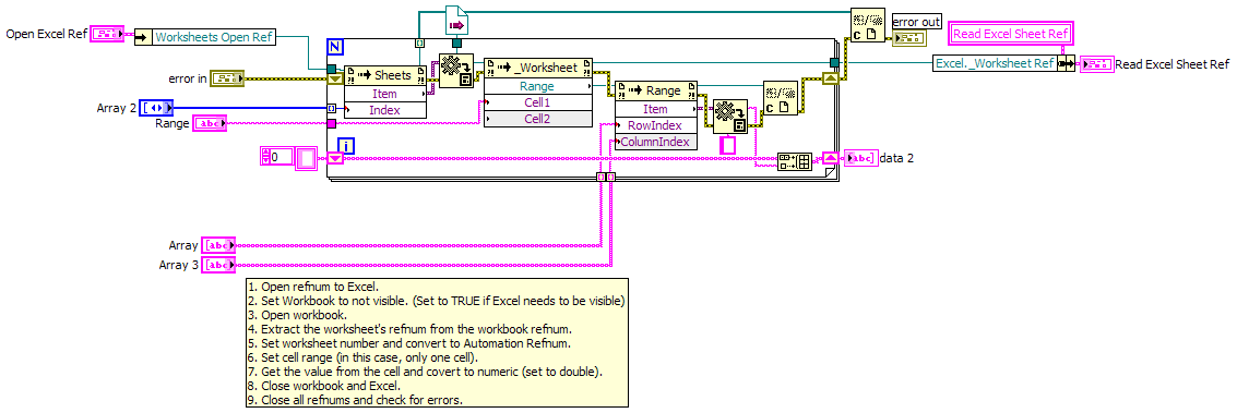

Excel Reference Issue with attached VIs in LabVIEW 8.6
We have created some VIs to demonstrate issue as attached in zip file. Find comments/procedure for issue creation on Front panel of "Excel Issue Main VI.vi".
If someone have solution/suggestion, please share with us.

You need to change the way you are handling the data out of the range invoke node. I made your vi output the string to the build array and then I build an array of string. Once you get those you can convert them to integer if you please. See below:
