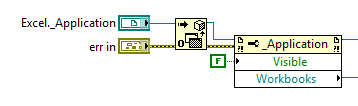

 You can set the "visible" property of the Excel application reference to "False".
I don't typically use the report generation VIs, so I expect you'll have to modify whichever one opens the Excel app reference and save it by a different name.  I pretty much always interact with Excel directly using ActiveX, so I'm not sure which VI you'll have to modify.

That's very nice.  It worked perfectly.  I just went into that rountine and changed it for good.  You mentioend that you use active x exclusively without the report generation toolkit.  Why is that?  Isn't that a lot of extra work?
