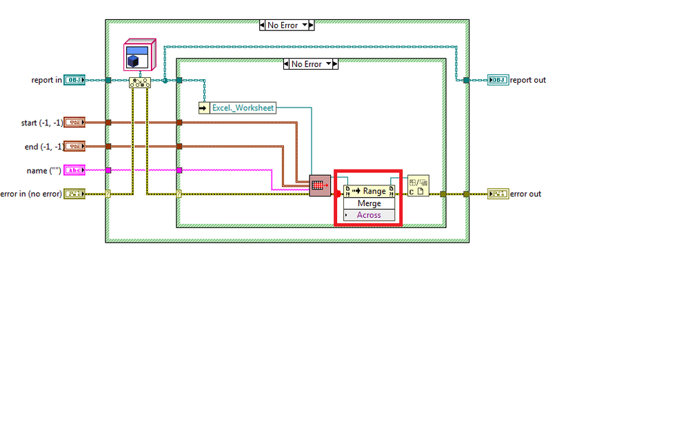

That wasn't it but it gave me some time to dig into the issue. The issue, at least in my case, is the NI_Excel.lvclass:Excel Merge Cells.vi with the Range.Merge Invoke Node. It works under any state other than when Excel is minimized, then an error occurs.
I do have a workaround (don't minimize Excel) but I wonder if this as been brought to any NI Rep.
