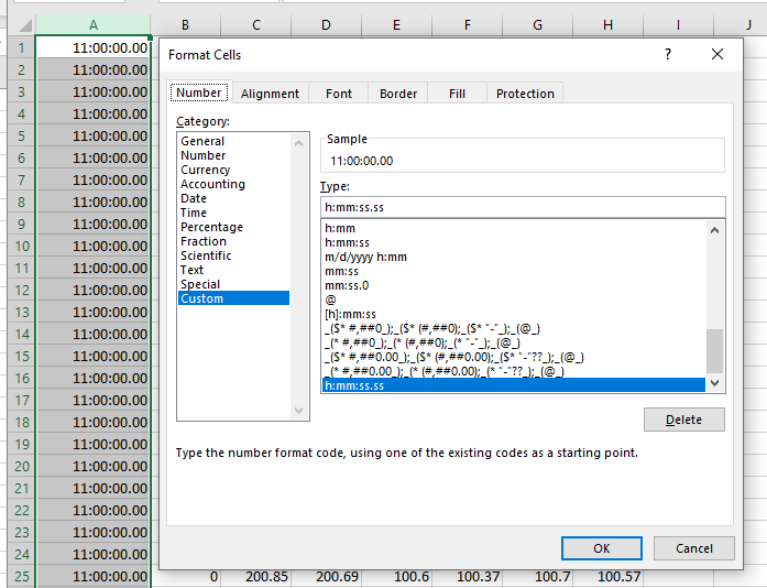

How is the timestamp invalid, it is able to show date, month and year, hour, minutes and seconds, AM and PM based on the format we choose.
Tried adding ".sss" after ":ss" but it did not work. Can you make a excel which has timestamp having millisecond.

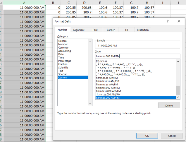

I think he should have said .000
This format works for me:    h:mm:ss.000 AM/PM

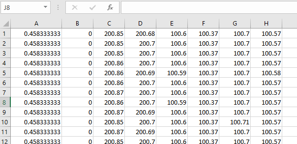

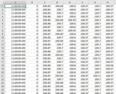

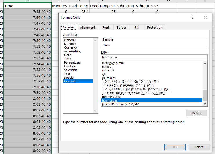

I tried changing the format of the file you attached and could not format it.
If I remove all formatting your time stamps look like this (all the same time!)

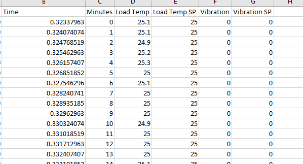

A proper timestamp, the raw numbers change with time

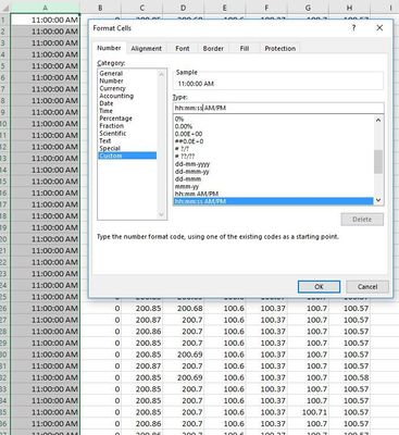

I copied and pasted your format (h:mm:ss.000 AM/PM), but it didn't work for me, can you share your screenshot.
Because as I said the timestamps are invalid in the data file you attached!
