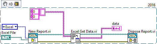

The report generation toolkit can read Excel files.  Note however that it not only requires Excel to be installed, it will actually open the report in Excel before reading it - so it is very slow.read excel.png

Look at BowenM's original suggestion.  Since you did not post any code, we can't tell much about your environment, such as your LabVIEW Version.  Do you have access to the Report Generation Toolkit?  Do you have Excel installed on your PC?
There is third-party software that provides "hooks" into .xlsx files without requiring the RGT, nor (I believe) even Excel.  I apologize to its Developer (whom I've met at NI Week), but don't remember the name of the Product.  However, you can probably do a Web search and find it, and it is also probably on the LabVIEW Tools Network.

You could also look into using ActiveX, but this is what the RGT uses under its hood.  So its almost the same thing where you would have to have Excel installed; however, the you wouldn't need RGT installed.
