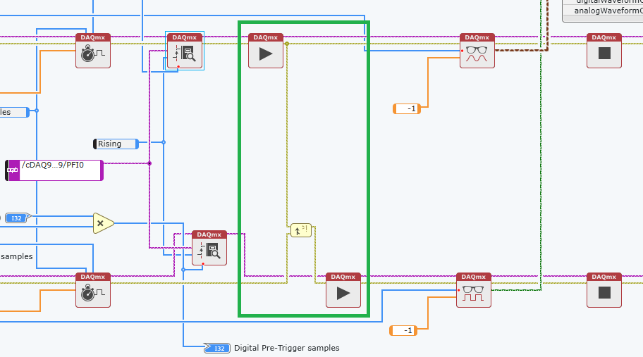

  • The two Start tasks don't have direct execution ordering, and maybe this is some sort of race condition (one task is configured and starts first, while the other task is still being configured). You could use error wires between the two Start task to enforce execution order. Example (clean- up your block diagram and then use Retain First Error):
