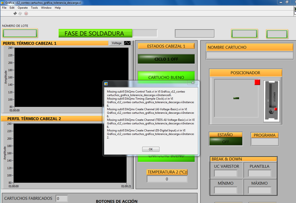

I have the same problem, but in my case, I restarted.
The fact is that I have a  program with 9 sequencial vi's. the 8 first do not interact with the DAQ , the error apperas on the last vi.
So, a do not know what to do...
