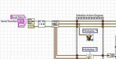

It seems that you are using some relative path.
Make sure that the excel files are placed in the same relative path to the exe file, as it is now for the vi file.
We can't see from any of the pictures how your files are organized on the harddisc.
There is nothing in the vi. properties that can help you, the onely thing is getting your path to your files correct.
