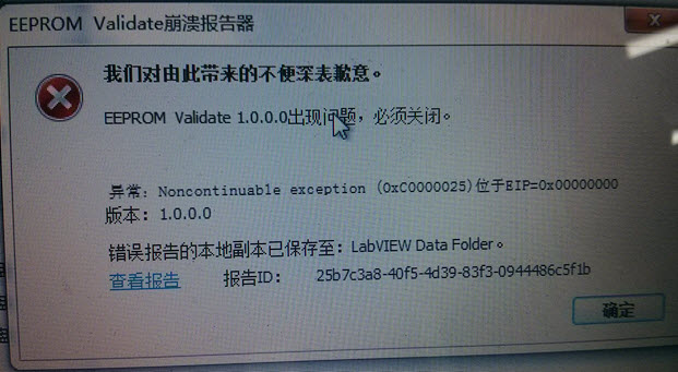

I have written a very simple application which uses an FTDI cable for writing to an EEPROM. I have built it into an executable and into an installer and installed it on a PC and it worked fine.
I have since distributed the installer to China and they are unable to run the software.
The english parts of the error say Noncontinuable exception (0xC0000025) EIP=0x00000000 and it also mentions the 'LabVIEW Data Folder'. This is the error message:
Is this a localisation issue or what else could be the cause? They've tried it on 3 computers and I've personally installed on one of them and nothing went wrong during the installation.

I've done a bit of research on the "Noncontinuable Exception" error and it seems to pop up when a VI doesn't compile properly. What happens if you try rebuilding the executable and installer? Are you able to take the project to another PC and try compiling it into an installer there and checking if that installer works better?
A second potential cause might be the fact that you're running it in China... You mentioned a version that works fine: does that version include Chinese caracters in it? I ask because there are known issues surrounding chinese caracters (please see the link below) and I'm wondering if that might have something to do with it.
