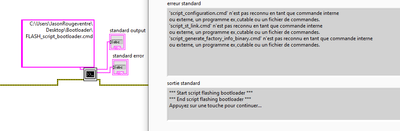

Hello !
I want to execute a Windows script ".cmd". This script execute other script so i execute the main script using System exec but it doesn't work and gives me differentes error  :

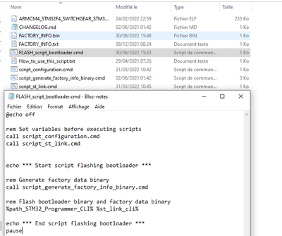

For information the script i using program a STM32 micro
Can you  help to resolve this problem ?
The script work without Labview
Thank you 🙂
Jason

It's often useful to connect the "Working directory"
Qestit Systems
Certified-LabVIEW-Developer
(1,259 Views)
Thank you ! Why i didn't think of that before ahah ...
(1,248 Views)
That's actually a tricky one! Most things work without it as long as %PATH% is correct, but sometimes it's needed.
