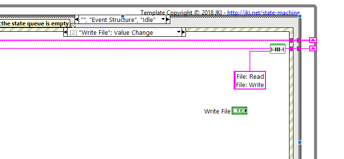

I made an example using the JKI State Machine. Let me know what version of LabVIEW you are using so I save it correctly, if you are interested.
The main idea I want to convey is what happens after a event, and that can be shown in the picture below:
The Write File Button is pressed; then the program goes into the File: Read State, and then the File: Write State. The event here is not a processing node, but a trigger to execute a sequence.

How would this JKI state machine control the execution order like the one I asked? I know you all said that the 'signalval' is a trigger BUT It's still executed after other code soon or later which is poor design.
Your JKI is just another state machine with 'while', 'event' and 'case' loops using shift registers for tranfering values between states instead of the typedef like I did. Both are the same logic. Seems like LV is pretty weak for this execution order scenario

There is no signal value property node in my example; the trigger is the event of the value changing.
Separating the trigger event from the subsequent process is extremely powerful in my opinion. For example, assume you hit the close window X in the corner. If you handle the trigger directly in the event it would be cumbersome to program. For example, you would have to see what other windows are open, what memory is being used, what references are open etc, all within the event. By decoupling the trigger from what you want to occur later makes for more modular and adaptable code.
