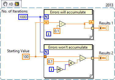

Generally, it is a bad idea to iteratively adjust a floating point value. With every iteration, your error grows bigger.
Here are 2 ways to decrement 100 by 0.1 until it reaches 0:
  • (This is what your code does) The top loop takes a value, subtracts 0.1 from it, and then stores the result in a shift register. In the next iteration, the value in the shift register is retrieved, another 0.1 is subtracted from it, and the result is stored back in the shift register for the next iteration to use.
  • The bottom loop doesn't use results from previous iterations -- it takes the original starting value and computes a new value to subtract.
If you probe this output, the last value of Results 1 is 1.404E-12 (10000 times greater than what you got!), while the last value of Results 2 is 0.000E+0.
When you multiply all your inputs by 10E6 and divide the final result by 1E6, you managed to shrink the errors a bit, but they are still there and they're still growing. If your number of iterations increase, your error could become significant again.
P.S. Do you understand what Altenbach meant when he said that your code has race conditions?
