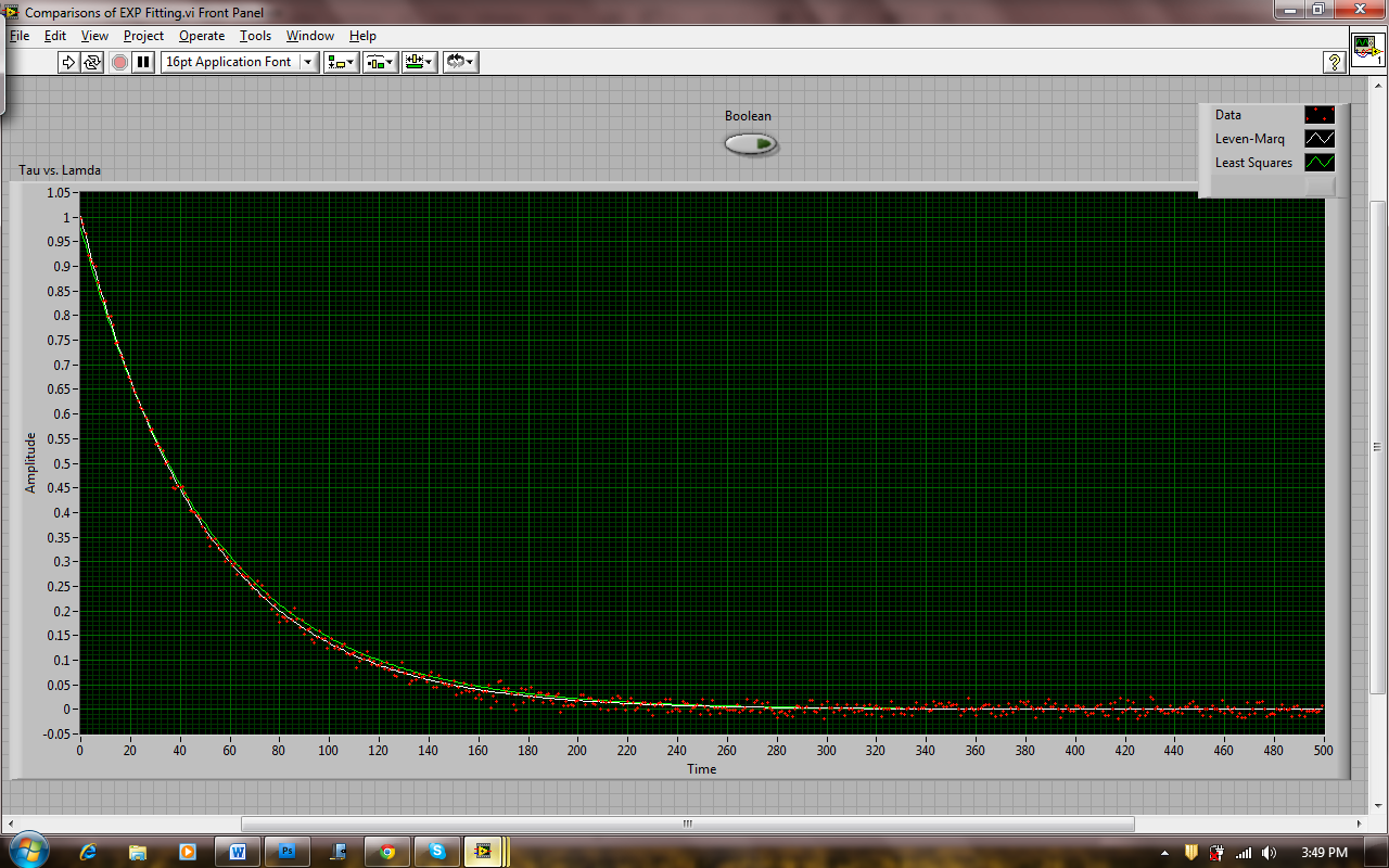

Are you saying the red data (the noisy data) doesn't look like a Lorentzian? I've upped the noise a lot to demonstrate the exponential problem, and the difference between the orange dotted line (theoretical exp) and the green line (best fit exp) on the EXP graph below.

ComparisonsI've included a picture here for the exponential data and 'fits'.
The red noisy data is an example of what I'll be collecting... the white line is a fit done by method of Levenberg-Marqaurdt. I like how that fits. 😄 The green line is the best fit resulting from the Exponential Fit VI, using least squares method. I guess, I didn't expect the difference to be as large as it is... if we get a lot of noise in our samples, the resulting fit is going to be AWFUL since we're working with super small numbers.
Anything to say on the matter or are me and my lab just crazy?

You have a pretty old LabVIEW version and the "unconstrained exponential fit" you are using is not directly supported, according to the context help. Wire a "refine=TRUE" to the lower input and things look better.
Substituting the toplevel exponential fit from the palette gives excellent results.
