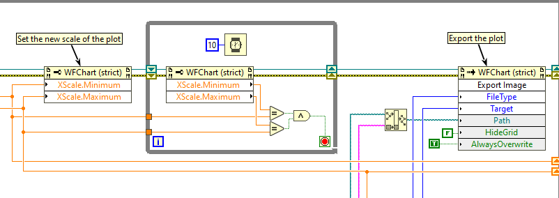

If the system can be busy with other processes, try adding a check that the scale has the desired limits:
(1,768 Views)
A simple answer to my complex problem that might actually work 🙂
I'll try this out as soon as I get the chance
