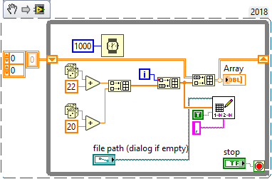

The VI I'm looking at is this one:
If that's what you're talking about, then connecting
  • a Chart to the same wire that is going to the Write Delimited Spreadsheet will give you all of the channels (including the "time" (i) channel, which would just be a straight line on the chart).
  • a Chart to the thick orange wire before the Build Array with the i would give the two channels
  • a Chart to either (one only) of the thin orange wires going into that Build Array would produce a single channel (sounds like what you want).
If you want to use a Graph (not a Chart), then you'll need to store the historic data too (like you're doing with the 2D array going to the "Array" output.
You could either
  • use Index Array on the 2D array wire, and then connect that to a graph
  • connect the data source you want (i.e. one of the orange thin wires after the "+" in the current picture) to a Build Array node via a Shift Register to form a thick orange wire (1D array) and then graph that with a Waveform Graph (but not an XY Graph)
That would be more complicated than directly using a Chart though...

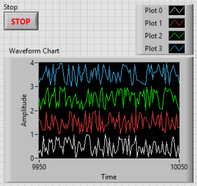

I am puzzled why you are having trouble.  Here is a demo of a 4-channel DAQ device (inner 4 loop) running at 100 Hz (wait time of 10 ms) that I ran for >10,000 samples without a problem.
Bob Schor
