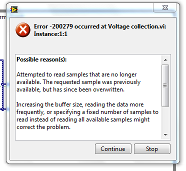

I appreciate your quick response. I have attached an image of the error I get. Can you tell me what block I need to add to the write to spreadsheet in order to specify the file? and could you possibly explain how to add in the string conversions / build the 2d array of strings?

Error

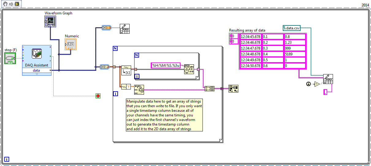

That error is because you're not reading fast enough for your acquisition. Basically, you're pulling data in at 1kHz, but your buffer is only 1000 data points, so you better read faster than every one second. Since you're browsing for the file every time you are writing, that takes longer than a second for you to find the file I'm sure.
Here's a guideline for what to do the simplest way. This is NOT scaleable, so I would suggest you look in to design patterns if you want to grow your application. Writing the data to file with every single loop in the same loop thjat you're acquiring could potentially slow down your loop to the point where you see the above error again.
