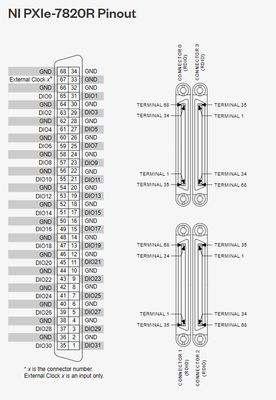

i'm using PXie-7820R( that have 4 connector )
when i  using external clock for connector 1, is it syncronization with other connector automatic? or i connect physical line  connector 1 ~ 4 ?

There are 4 External Clock input pins, one on each connector.
You need to use these External Clock in your FPGA design to select which of these 4 clocks to use, and it is not limited to just that connector.
