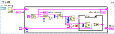

Hello

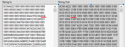

I'm trying to create a bootloader app, which would send parts of intel hex file to the atmega128 we use. I have trimmed the intel hex file and tried to convert it to true hex (as opposed to ascii hex in which intel hex is written). I did so with typecast to string, but noticed that occasionally a stray '0' would be in the output string. 
Example:
Instead of 'F1F' it's converted to 'F10F'.
Any ideas as to why this happens? Am i missing half a byte somewhere so it just appends it?

It was a line feed character...

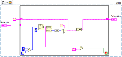

Overall, you code could be greatly simplified because you know the numer of iterations from first principles (i.e. half the string length) so a FOR loop seems more appropriate.

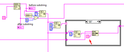

I put it there in previous loop 😄
Also thanks for the simplified code 🙂

Somehow my gut feeling tells me that your "previous loop" code could also be simplified quite a bit, but it's hard to tell from a picture alone. 😉

It basically just strips data from the hex file. Removes first 7 characters and last 2, then checks if the first characters from stripped row are '00' (which signifies data row in intel hex) and stores them if it is.

Hi AeroSoul,
try this:
