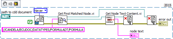

The simplest way to extract the data that you need from XML (the format used in a Candela .cdd file) is to use XPATH expressions.
Here is an example of getting the value from a formula node using the LabVIEW inbuilt XML parser.  The "Get First Matched Node.vi" evaluates the XPATH expression and returns the first matching node.

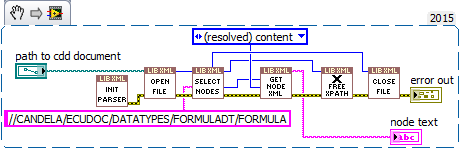

You can find the LabVIEW libxml2 wrappers here: https://forums.ni.com/t5/Example-Program-Drafts/Parsing-XML-is-too-slow-or-is-it/ta-p/3492686
This is what the solution looks like using the libxml2 wrappers...
