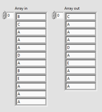

Hi, I am trying to write a simple program that extracts all elements containing a given element (the element to extract will be hardcoded) and the element before it. I have attached a screenshot containing example input and output. In this example code, the elements I want to extract are all elements containing 'A'. My data will be structured that all desired elements (in this case 'A') will be squeezed between unwanted elements (in this case C, D and E), but the desired element can also be in the first index. Does anybody know how to implement this in an easy way?

Your requirement isn't well-defined!
You want to read the "given element and the element before it": in your example there are three consecutive "A" elements - according to your requirement you should result in 5 consecutive "A" elements (with an "E" in front) in the output array!!!
So please write down the requirement WITH ALL considerations/"border effects"!

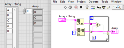

Going by your picture: Instead of looking at the element before, look at the next one. If either the current or next element is an A, keep the current element.

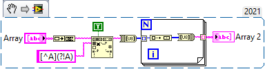

My understanding is to remove every element that is not A AND not followed by an A..

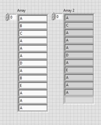

Hi, yes almost.
the goal is to extract all strings containing a given element, in this case A. and the two adjacent elements that are NOT A.
I have implemented something that I think works. It is pretty messy so if anybody has some suggestions on an easier way to implement this I would be happy to see it.

In your first message you gave as input:
  BCAAADABEAAA.
The desired result was given as:
  CAAADAEAAA
When you want "A and two adjacent elements" then why is there no "B" in the output???
