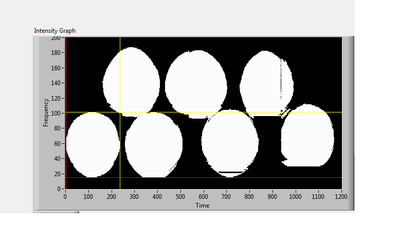

Hello GerdW,
Appreciate and its awesome. Whyi cant think like that?
I am unable to think straight now. Could you give me a logic to exract one of the disk (index values)?
Regards
Guru (CLA)
Message 11 of 13
(719 Views)
What logic  i should apply so that i can move the yellow cursor to find the "right" and the "top" end of the first disk and proceed to the next ones? (with both the yellow and red cursor)? I am using LV 2013...
Regards
Guru (CLA)
Message 12 of 13
(709 Views)
Hi Guruthilak,
how about the Flood Fill Algorithm
here's a very basic implementation in LabView 7 from wiebe@CARYA: http://forums.ni.com/t5/LabVIEW/Floodfill-Algorithm/m-p/438947#M214627
