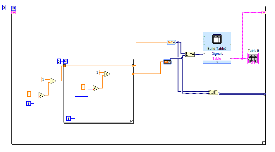

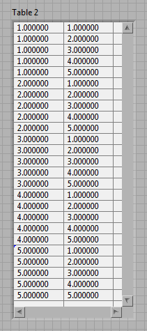

I have this loop to create a 2D array. The result is on the below table. I want this 2D array to be fully completed and compiled then it will be send out of the loop.
I do not want to extract the 2D array value while it is looping.This is the problem i am facing.
My ultimate aim is to extract the individual row of number from the final table of 2D array and to be an input for other functions.
Please help me. Thank you

Hi PX,
here's a solution without using express VIs Smiley Wink
(3,454 Views)
This is perfect !!!!!! Thank you
