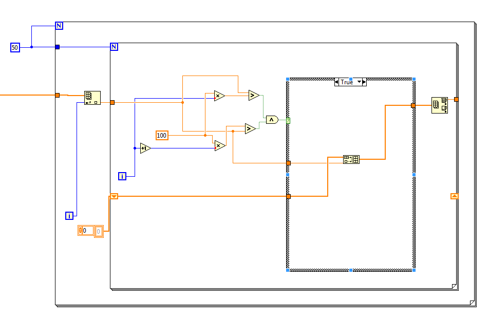

Accepted by topic author pengxin
This assumes your array is sorted.
If you use the quotient remainder function between the current value and the next one in your array and compare the quotients, you'll know whether the next value is in a new hundred, thus making the current value the highest number in the current hundred.
Message Edited by Ravens Fan on 03-24-2010 12:52 AM
