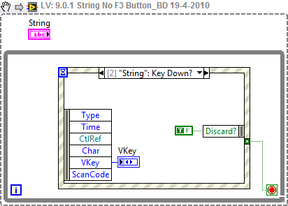

I can reproduce this:
Furthermore, it happens on any type of control.
Ton
PS the fact your snippet didn't include the event right is because you use the standard snippet function of LabVIEW.
Download the Code Capture Tool to have a more flexible snippet tool
