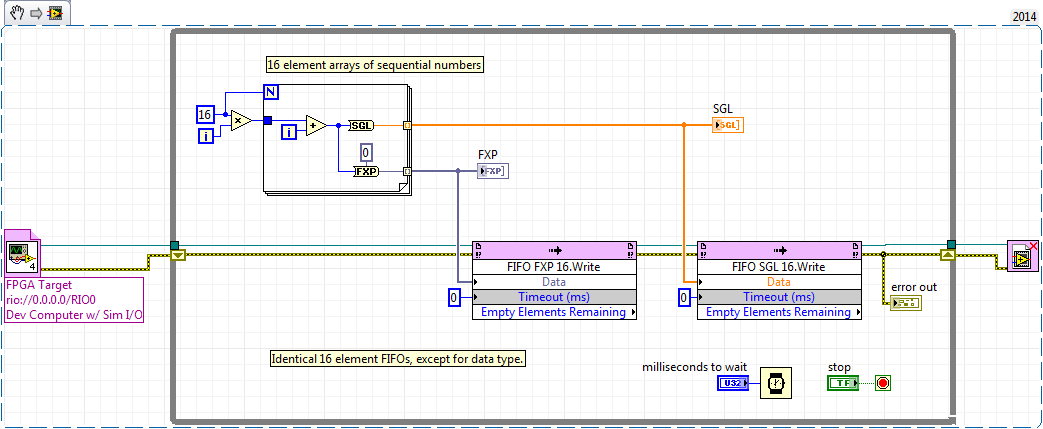

I have two Host-to-Target FIFOs, identical except for type: one is FXP the other SGL.  Both are 16-element.  The SGL data that is read appears to have a conversion error.  A minimal example project (2014 for the 9066) is included.

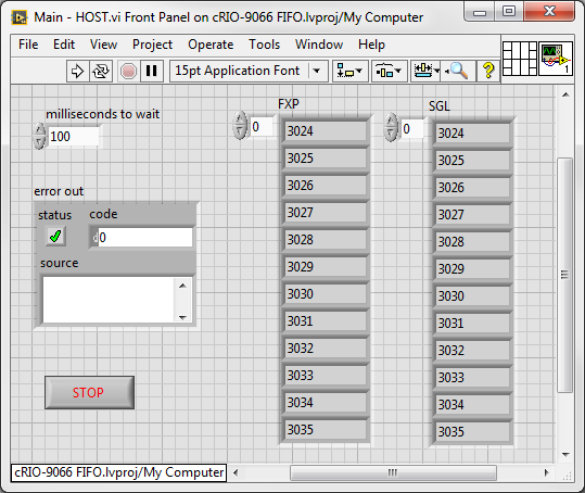

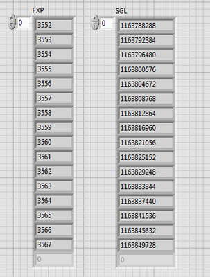

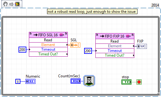

Data send thru a multiple element SGL FIFO is incorrect when read on the other end  Screenshot is the data as read by the FPGA.  Shoud be the same.. Main - HOST.pngMain - FPGA.pngScreenshot.png

Is the front panel you're showing from the top snippet?
If so, the problem is entirely independent of the FIFO and the FPGA.  It's entirely in your RT/Host code.
That's also the only place you're seeing a conversion.

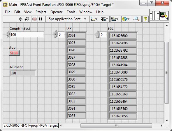

No.  It's from the bottom one, the reader on the FPGA.    The same screenshot from the top snippet (the PC) shows identical data.  Change the FIFO to a single element and loop the read and it works fine.

It looks like it may be a bug in the simulator.  Get out of simulated mode, run it on your target, and watch the interactive mode that way.  The results are what you expect.  It's strange they would be converted at any point.

Verified OK on the hardware; you are right it is Sim Mode bug only.
