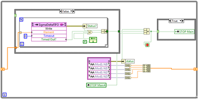

i'm currently acquiring data from two different kind of sensors using a cRIO9039 and labview 2016. Since i use both a NI9234 and NI9220, who have different clock rates, i need to use 2 FIFOs to pass data from my FPGA side to my RT side.
SAR acquisition loopSAR acquisition loopDSA acquisition loopDSA acquisition loop
Both loops are written so they acquire data at 12.8kHz. In the SigmaDeltaFIFO i put 4 values each iteration, in the MEMS FIFO it's 32 values. In the RT loop i read out the data and decimate it back into the seperate measurements.

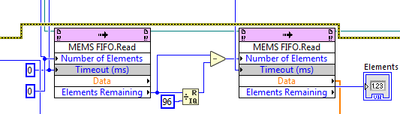

The Elements Remaining of the MEMS FIFO should always be a multiple of 32. During a 10 minute measurement i sometimes get a TimeOut error from this FIFO and have only 31 Elements Remaining. What could be the reason / solution?
This problem does not occur during every measurement, and it never occurs at the same time. Sometimes it happens after 30 seconds, sometimes after 9 minutes.

I wouldn't put a wait in the read loop. Read as fast as possible, and let the TO of the read introduce a wait if it's idle.
The feedback node in that FIFO write loop probably isn't right. It will remember status from previous iterations, so an error of the 4th element will be remembered for the next 1st element. You probably want to use a shift register for that.
If there is an error, you're in trouble, and it will be impossible to recover anyway. Once multiple channels over a single FIFO are out of sync, there's no way for the reader to get back in sync.

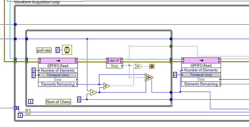

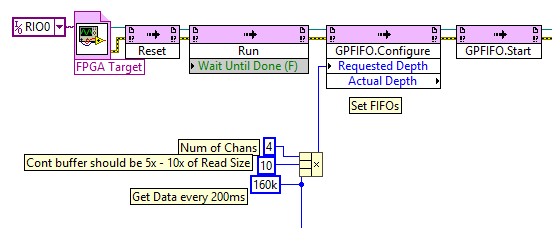

I'm neither a RT or FPGA savant, but you can try this on the RT side:
  1. Configure the depth of the FIFO; should be 5-10x times the read size.
  2. Read the buffer every 100-200ms; I used 200 ms in my application.
  3. So in your case, 12.8kHz, in 200ms, 2560 points, times 32 channels, make the depth 2560*32*10 = 819200
  4. Read 163840 elements every 200 ms.
Below are some images.
800kSa/s, 4 channels800kSa/s, 4 channelsRead data every 200ms, amount of data needs to be larger than 4*160kSaRead data every 200ms, amount of data needs to be larger than 4*160kSa

Okay, it's running smoothly now. I ran tests for a couplt of days under different settings and i haven't encountered this error yet! Thank you!
