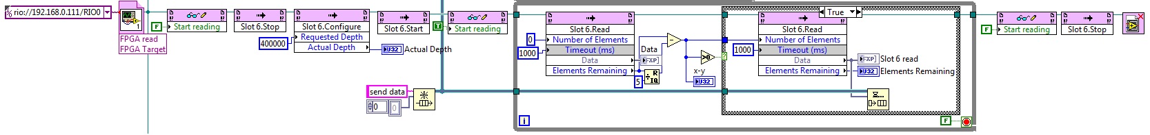

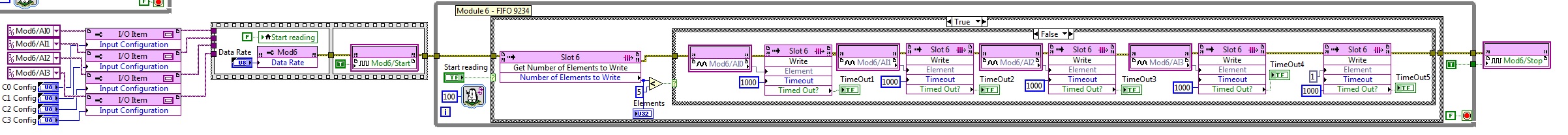

Hey,
 I have now tried stopping the FIFO before starting it, and have increased the 'Requested Depth' like you said, but again it doesn't seem to have made any difference.
This is currently what I have after making all of the changes that have been suggested to me.
FPGA Code:
Real Time Code:
Can anybody see where I'm going wrong, or have any other suggestions that I have not tried yet?
Any ideas are welcome, I'm getting slightly frustrated with this now! 😛
Lou
