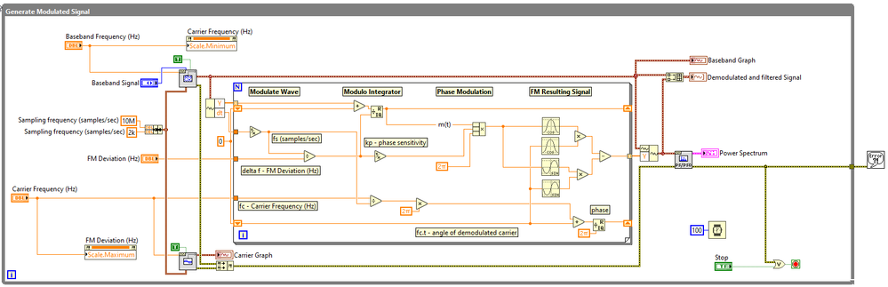

Hello, i have done the FM modulation but i can't  recover the signal while demodulating ,i will appreciate any help

I am sorry i forgot to mention the main problem ,during demodulation the signal gets attenuated  when i reduce : frequency deviation , carrier frequency and baseband signal frequency  but when they are high the signal seems fine , please help

Look in the Example Finder under FM. This is what I found. I really can't follow your VI, but it doesn't look like you are doing the mixing correctly.

the modulation part works ,it is the demodulation that is the problem

I can't reproduce your picture with your VI; the plots just show zero. From the bottom plot in your picture it looks like you are demodulating the message.
I did something similar awhile ago, on a FPGA, where I multiplied the modulated signal by Cos and Sin of the carrier frequency, low pass to get I & Q, then do the Arctan to demodulate.

after you run the vi adjust all the parameter like baseband frequency ,amplitude and so on ,you will see the plots
thanks for the advice it really helps
