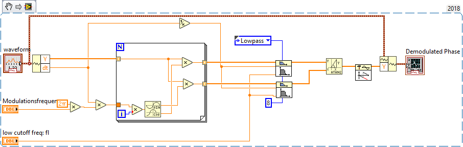

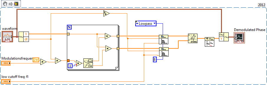

here is a quick untestet phase demodulation,
for more help please post that wfrm 🙂

If you captured that wfrm(.wav) with a soundcard, it migth be that the sampling frequency has a tolerance ... that would show up as a constant drift in the demodulation ....
So if you know the number of periodes for one turn of your table, you can compensate this effect.
(Simply by changing the Modulationsfrequenz)
low cutoff freq should be somewhere in the 100Hz .....

Sir I used this VI but I have a little phase problem here. Sir can you help me with180 phase shift
Message 8 of 10
(7,199 Views)
Swap SIN / COS multiplication 🙂
as written 7(!) years ago...  untested 😄
Greetings from Germany
Henrik
LV since v3.1
Message 9 of 10
(7,180 Views)
Hi, it works, thanks!
