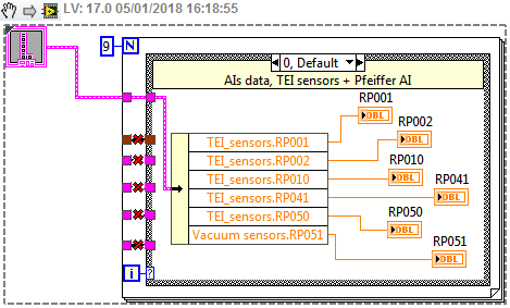

In a particular case I just used a simple FOR loop and a Case structure to accommodate many indicators to save BD space (42 indicators...I swear, this number is accidental! 😄 ).
I know I should use clusters to group up indicators (in this case this was not an option due to special GUI reasons), or to use SubPanels loaded with display VIs (neither was a comfortable option).
Anyway, my actual question regards to performance of such (not really elegant) constructions during runtime: distributing many indicators into such structures impact the runtime performance? If so, should I enable loop iteration parallelism? Would it make any difference?
Extra info: the loop where this construct is placed, iterated with a slow speed of 1 Hz.

As long as those indicators are NOT set as "Syncronous" I suspect it will not make much of a difference.
Going even farther...
Since they only get updated 1/second you would most likely be able to update those indicators using control references in a sub-VI... unless your UI Thread is already over-loaded.
It will affect performance.  Enough for you to care?  Probably not.  Will parallelism help?  Try it an see.  My guess is not.

I suspect we would have a very difficult time even measuring a difference in performance between doing it in a For loop or not.
It becomes a philosophical question;
"If a code change impacts performance but there is no way to measure the impact, ...?"

The broken wires distract a little bit. So is this only one big cluster or several small clusters that you unbundle in the various cases?
I agree with Ben that you won't notice an impact, these are just scalars. Updating the UI thread is asynchronous anyway.
However, this is one of the rare cases where a stacked sequence would actually be a better alternative (only inputs, no outputs or sequence locals). I would probably use that! same functionality!
Personally, I would also move the terminal labels to the right and stack the terminals nicely without wire bends, but that's just me. 😄
Message 6 of 19
Yes, several smaller ones.
Ok.
Hmm, sounds reasonable!
This was a kind of "fight back" against my OCD 😄
