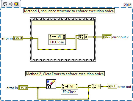

Remember that you can also just bypass the error input of the FP Close node if you want to keep the errors for handling, and merge its error out after.  Just remember you need to make sure the FP.Close fires at the right time using a method of execution order enforcement.

Now this is the info I was looking for in the first place. Strange how I found nothing before today. Maybe I didn't search well enough.
The second method is the one I implemented, even though the first one was more ingenious.
