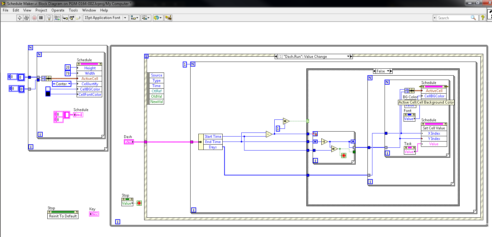

Going to try this witha photo and then maybe someone can tell me what in my logic is making it overwrite the previous entry's information. It happens everytime i press the run button, but it only overwrites the previous runs data and inputs it's own data.
We cannot tell much from the code image, because we don't know the values in the various wires.
Still, it seems you have 80% too much code and some quite questionable constructs:
  • Do you assume that the FOR loop stack on the left executes before the while loop? Since there is no data dependency, while and FOR loops will run in parallel.
  • Also the "reinit to default" of the stop button executes in parallel. Most likely you want it to init before the while loop starts, right?
  • Why don't you use a latch action button and associated event for the stop button? No property nodes needed.
  • Again (on the left inside the FOR loops), property nodes execute top to bottom, so you probably want to set the active cell first, before defining the width and height.
  • What is contained in the array diagram constants on the very left? If you want to apply it to all cells and headers, set the active cell to [-2, -2]. No loops needed!
  • Why do you write the same diagram constant to the "schedule" indicator NxM times on the left. Once is probably enough! (move it out of the FOR loops!!!)
  • The Outer FOR loop inside the event structure serves no purpose.
  • You can wire the numeric directy to the case selector and make one case "1" and the other the "default". No "equal 1?" needed.
  • What's up with all these value property nodes? Where is the terminal (If you cannot use the terminal, use a local variable!)
There are probably plenty of other problems in the other event cases and other parts of the code that we cannot see. These are all deep cracks where bugs can hide unseen. 😉
